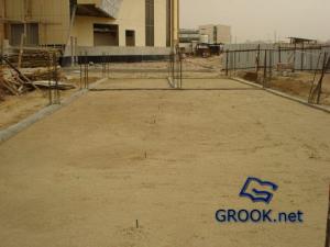

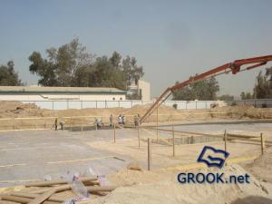

fixing levelling bars for concrete level
or fix leveling rods

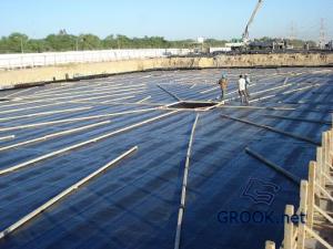

spread Nylon on ground (to keep water in concrete)

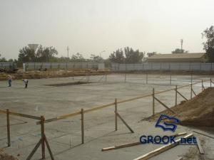

start casting concrete (plain concrete)

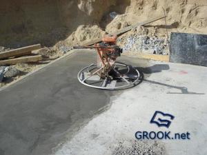

laying, spreading, leveling, vibrating and finishing concrete

So after we cast plain cocrete , now our site clean and ready to start work in Reinforced Concrete

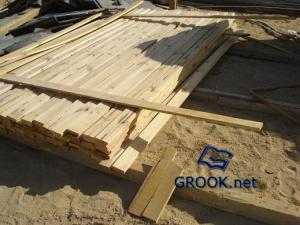

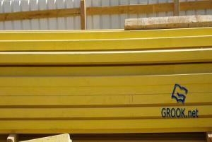

CONCRETE FORMWORK

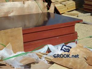

Concrete Form Plywood

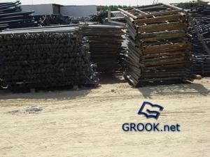

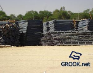

Scaffolding

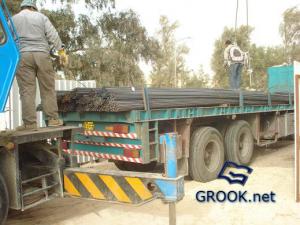

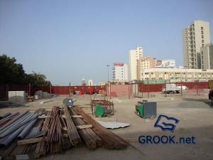

CONCRETE REINFORCEMENT
Install Steel cutter (Saw) and Steel bending machine
Install steel bars
