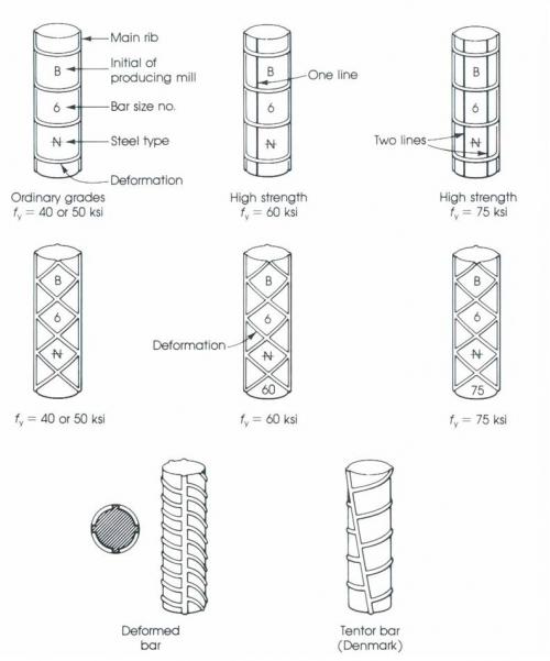

  • Standard Reinforcing Bar Markings

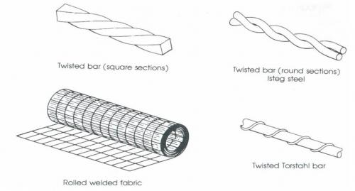

  • Most common types for non-prestressed members:
            hot-rolled deformed bars
            welded wire fabric

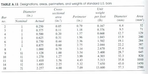

  • Areas, Weights, Dimensions

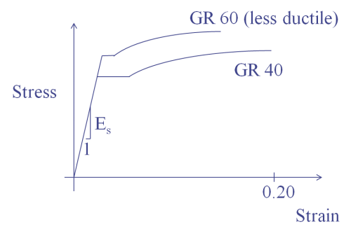

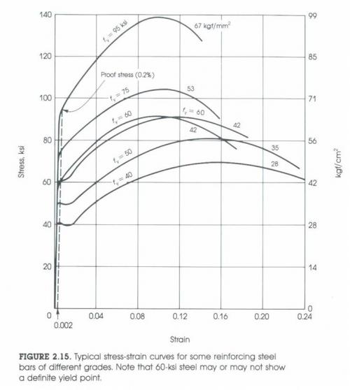

3.  Stress versus Strain
  • Stress-Strain curve for various types of steel reinforcement bar.
  • Es = Initial tangent modulus = 29,000 ksi (all grades)
  • Note:
  • GR40 has a longer yield plateau
