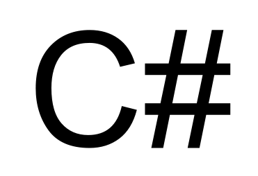

Just click the Select File button (or manually copy a file path into the File Edit Box. Click the Generate button and a password will be generated from the file you selected. You can type in a text modifier into the Modifier edit box (any text, the longer the better) and also a numeric offset into the file. This is how many bytes in from the start of the file to read.
The class FormLPG does all the work. There are event handlers for all three buttons. Click the Select File button and the OpenFileDialog provides the full path and filename which is copied into the File Edit Box. The class FileInfo is a handy way to get the size of the file and this code demonstrates that even an expression is an object with an inherited ToString() method!
