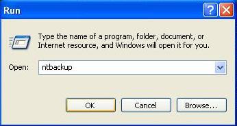

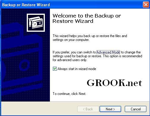

1- Start => run => ntback

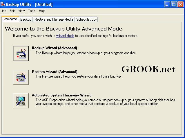

2- If it is the first time, it will show you the Wizard. Click on "Advanced mode".

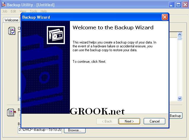

3- This is the NT Backup Utility console. To start a new backup task, click on "Backup Wizard (Advanced)".
4- First backup wizard screen is only Welcome message

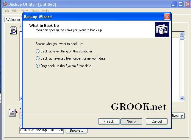

5- In What to Back Up screen you can choose for what you want to take a back. Choose "Only Back up the System State Data"

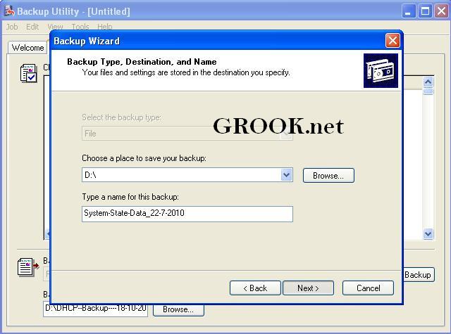

6- In Destination screen, you have to specify the location of the output file. Grook.net advice to save it on external place (e.g. flash, External HD or SAN)

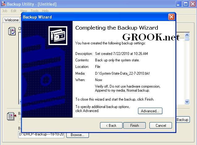

7-last screen is to summarize the task. We will Discuss later-on about advanced option in grook.net

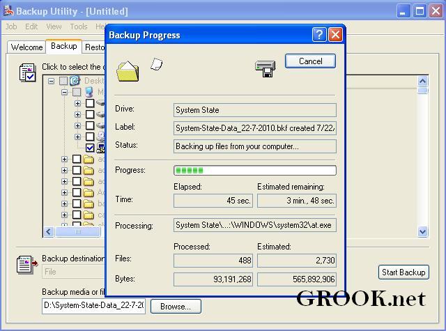

8- Finally, the task is under progress.
