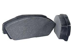

Front brake pads provide up to 70% of vehicle stopping power. In general, front brake pads wear out twice as fast as rear brake pads, 2 to 1. Disc brakes have a definite braking power advantage over drum style brakes and performance is not compromised as much when wet. Some disc brakes utilize cooling fins in-between the braking surfaces to maximize cooling efficiency. Replacing brake discs can vary depending on the make and model of car or truck, two wheel or four wheel drive. Always replace
brake rotors with top quality or OEM (original equipment manufacturer) brake rotors, some less expensive brake rotors can squeak and not dissipate heat as well because of their inferior metal quality.

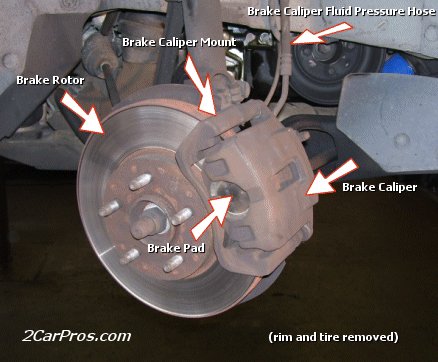

Step 1 - Identify Front Disc Brake Components
Most front disc brake components include: brake rotor, brake pads, brake caliper, caliper mount and brake flex hose. Brake service usual occurs between 20,000 and 40,000 miles depending on driver habits road conditions and brake pad material used.

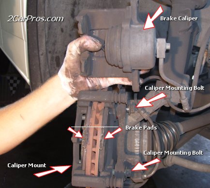

Step 2 - Remove Brake Caliper to Replace Pads
Locate primary caliper mounting bolts; apply wrench pressure counter clockwise to remove the bolt, upper and lower. Make sure the bolt threads are in good shape and replace if necessary.
Step 3 - Remove Front Brake Caliper
After removing the primary caliper mounting bolts lift the brake caliper mounting lift brake caliper off of the rotor and then tie or set gently to the side, be careful of the brake caliper flex hose not to bend or kink it. Thoroughly inspect brake caliper and brake hoses for leakage and replace as needed. Next loosen the brake pads and secondary caliper mounting bolts. Notice how great protective gloves work, most technicians use them on the job today.

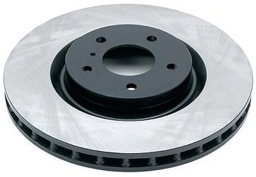

Step 8 - Installing New Brake Rotor
Install new brake rotor, the new rotor is manufactured with a protective film over the rotor, remove protective film before installing; also after the brake job is complete you may experience a small amount of smoke from the rotor when first used. This is normal and will go away after the first couple of uses.

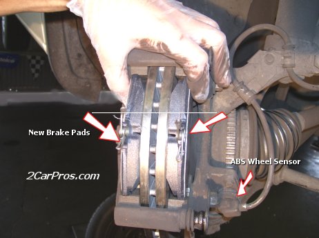

Step 9 - Installing New Front Brake Pads
Reinstall the front brake caliper mount, and then install front brake pads. Make sure the pads are not too lose or too tight in the caliper mount, it must be a close fit to work properly.
