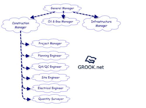

  • Organizational Breakdown Structure/Responsible Manager
An organizational breakdown structure (OBS) is a hierarchical
arrangement of institutions’ project management structures. The OBS
is rolled up to The Office of the President, and in general is a list of
the responsible managers.
- The OBS supports larger projects, which involve several
projects managers with different areas of responsibility.
- The OBS is assigned to EPS nodes, projects, WBS elements,
risks, issues, and thresholds to designate responsibility.
o Example: The OBS element assigned to a project is the
project manager responsible for all work included in the
project.
- The OBS controls user access to project information.
