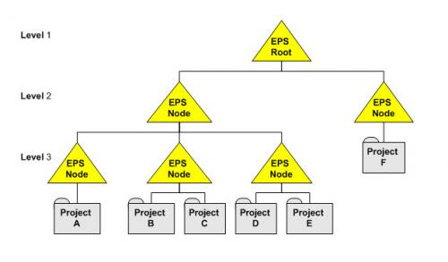

EPS: The EPS is a structure made of roots and nodes.
Root Element : The highest level element in an enterprise project structure (EPS), organizational breakdown structure (OBS), or a work breakdown structure (WBS).
EPS node: A level above a project in the EPS hierarchy.
o Each root in the EPS can be subdivided into many nodes.
o Nodes represent different levels within your EPS.

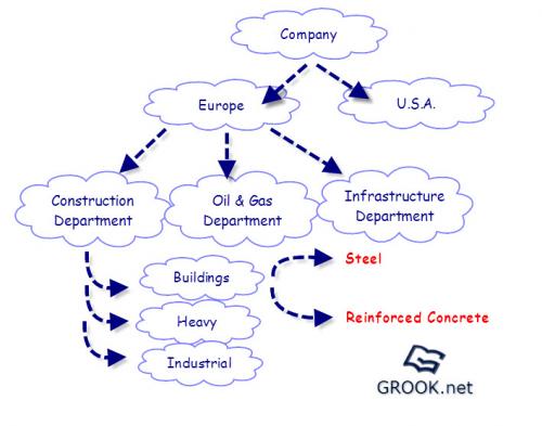

For example, nodes can represent divisions within you company, departments, or site locations.
o All projects must be included in the EPS node.
o Each node can contain an unlimited number of projects.
o Projects always represent the lowest level of the
o Placement of a project in the hierarchy determines the
summary level in which it is included.
o View project priorities, scope, and budgets across the
o Manage projects separately while retaining the ability to roll up
and summarize data across multiple projects.
o View cost distribution across projects.
o Assign security at any level of the structure to provide users
with appropriate access to project information.
